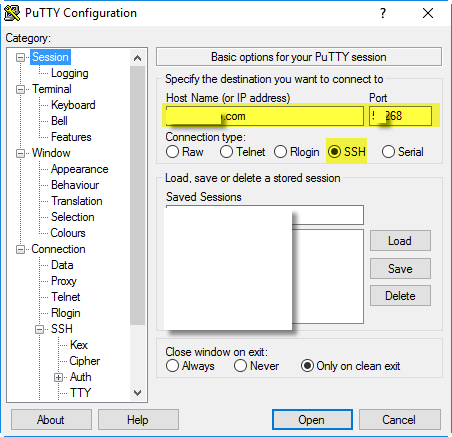

  4. Hello, Ayant trouvé mon chemin pour me log en root, je vous donne la recette ;-) Pour commencer, je n'ai rien inventé, j'ai trouvé mon inspiration ici : http://www.mauchle.name/blog/?p=239&cpage=1#comment-29143 Mes modifications sont en "jaune". (1) Download PuTTY and PuTTYgen (or just get the installer, everything is in there). (2) Generate a keypair with PuTTYgen (Parameters: SSH-2 RSA) (3) Save the private key as “myprivatekey.ppk” (4) Copy the public key to the clipboard. Looks somewhat like this : ssh-rsa AAAAB3NzaC1yc2EAAAABJQAAAIEAzP4MR3lkCD2pa7nwT3NMjjDBMmEuJ4exW4GKBBP+okArZ/IrjbLIpdh8ahpfgjh8kM//OVUGeRa1GigzcCuGzIa2YfS7L4Q9cbUUWFwIu2hGV3ZpJ2xDZExaaLH90Vw+ZBaozD2OI4FZ1Dqh8Bj29SQqIIbmxf/ASyTmXHZCbQk= rsa-key-20130414 (5) Connect to your diskstation with PuTTY diskstation:22 (6) Login as root admin (obviously the root will not work on DSM 6 ... so use any administrator account like the original "admin") (7) Elevate your admin user to "root" by typing (then all your command lines will have to be precidered by "sudo " to be executed as "root") : sudo -l -U root *** Steps 8 to 10 are probably optional based on CoolRaoul comments .... based on my experience, sudo remains needed otherwise you will not have the rights to open / change files *** (8) Edit the SSH config with sudo vi /etc/ssh/sshd_config (9) Look for the following lines (using the keyboard arrows up & down) : #RSAAuthentication yes #PubkeyAuthentication yes #AuthorizedKeysFile .ssh/authorized_keys (10) Change them to this (by hitting “x” when the cursor is over the # and hitting ESC, then typing :wq ENTER). There is not visible effect after having hitted ESC ... do not search and type :wq ENTER #RSAAuthentication yes PubkeyAuthentication yes AuthorizedKeysFile .ssh/authorized_keys (11) Go to /root and create the .ssh folder (the .ssh dir was already existing in my DSM ... try to go directly to 12. IF the step 12 is not working ... then type sudo -s Then, type cd /root mkdir .ssh Then, type Exit (12) Edit the keyfile sudo vi /root/.ssh/authorized_keys (13) Press “i”, paste your public key (right clic) and save the file (Hit Esc, type :wq, hit Enter) ssh-rsa AAAAB3NzaC1yc2EAAAABJQAAAIEAzP4MR3lkCD2pa7nwT3NMjjDBMmEuJ4exW4GKBBP+okArZ/IrjbLIpdh8ahpfgjh8kM//OVUGeRa1GigzcCuGzIa2YfS7L4Q9cbUUWFwIu2hGV3ZpJ2xDZExaaLH90Vw+ZBaozD2OI4FZ1Dqh8Bj29SQqIIbmxf/ASyTmXHZCbQk= rsa-key-20130414 (14) Set the access-rights to the file sudo chmod 700 /root/.ssh sudo chmod 644 /root/.ssh/authorized_keys (15) Disconnect with exit (16) Open Putty again and make the following settings In session : Hostname or IP Port: 22 Connection type: SSH In Connection Data->Auto-login username: root SSH->Auth->Private Key: Your Keyfile In session, save the session as <sessionname> (17) Open WinSCP Add a new site Select "SFTP" Add the Hostname (or IP) and SSH port Add as username "root" In Advanced > SSH > Auth > Auth parameters : select the same SSH key file as in (16) and tic the option "allow the connection agent" Save and log
