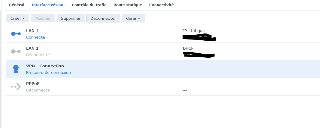

Bon, je relance le sujet car : la nouvelle version de DSM a permis d'upgrader la version d'OpenVPN...
Mais... je bloque toujours... impossible de connecter le NAS au VPN géré par le Raspberry.

Voici le contenu des logs :
2021-10-03T10:38:50+02:00 SYNO716 openvpn[9077]: WARNING: file '/tmp/ovpn_client_up' is group or others accessible
2021-10-03T10:38:50+02:00 SYNO716 openvpn[9078]: NOTE: the current --script-security setting may allow this configuration to call user-defined scripts
2021-10-03T10:38:50+02:00 SYNO716 openvpn[9078]: neither stdin nor stderr are a tty device and you have neither a controlling tty nor systemd - can't ask for 'Enter Private Key Password:'.  If you used --daemon, you need to use --askpass to make passphrase-protected keys work, and you can not use --auth-nocache.
A l'aide !!! 🤪
