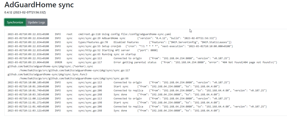

Bonsoir @MilesTEG1
J'ai achet& un Raspberry et j'ai mi adguard dessus comme prévu.
J'ai ce retour dans adguarhome-sync :
2023-02-26T19:10:00.196Z    INFO    sync    sync/sync.go:113    Connected to origin    {"from": "192.168.64.254:8080", "version": "v0.107.25"}
2023-02-26T19:10:01.465Z    INFO    sync    sync/sync.go:198    Start sync    {"from": "192.168.64.254:8080", "to": "192.168.64.105:80"}
2023-02-26T19:10:31.466Z    ERROR    sync    sync/sync.go:202    Error getting replica status    {"from": "192.168.64.254:8080", "to": "192.168.64.105:80", "error": ": Get \"http://192.168.64.105:80/control/status\": dial tcp 192.168.64.105:80: i/o timeout"}
github.com/bakito/adguardhome-sync/pkg/sync.(*worker).syncTo
    /go/src/app/pkg/sync/sync.go:202
    /go/src/app/pkg/sync/sync.go:186
github.com/bakito/adguardhome-sync/pkg/sync.Sync.func2
    /go/src/app/pkg/sync/sync.go:49
github.com/robfig/cron/v3.FuncJob.Run
    /go/pkg/mod/github.com/robfig/cron/v3@v3.0.1/cron.go:136
github.com/robfig/cron/v3.(*Cron).startJob.func1
    /go/pkg/mod/github.com/robfig/cron/v3@v3.0.1/cron.go:312
Tu veux bien m'aider sur le docker-compose stp ?

Bonjour  @MilesTEG1 merci pour ta réponse.
Je pense avoir tout bien paramétré  mais j'ai ce retour en sorti de log
2023-02-27T08:06:00.125+0100 INFO sync sync/sync.go:113 Connected to origin {"from": "192.168.64.254:8080", "version": "v0.107.25"}
2023-02-27T08:06:01.386+0100 INFO sync sync/sync.go:198 Start sync {"from": "192.168.64.254:8080", "to": "192.168.64.4:80"}
2023-02-27T08:06:01.661+0100 INFO sync sync/sync.go:206 Connected to replica {"from": "192.168.64.254:8080", "to": "192.168.64.4:80", "version": "v0.107.25"}
2023-02-27T08:06:02.699+0100 INFO client client/client.go:282 Add filter {"host": "192.168.64.4:80", "url": "https://adguardteam.github.io/HostlistsRegistry/assets/filter_28.txt", "whitelist": false, "enabled": true}
2023-02-27T08:06:02.923+0100 ERROR sync sync/sync.go:241 Error syncing filters {"from": "192.168.64.254:8080", "to": "192.168.64.4:80", "error": "400 Bad Request(Couldn't fetch filter from url https://adguardteam.github.io/HostlistsRegistry/assets/filter_28.txt: got status code 404, want 200\n)"}
/home/bakito/go/src/github.com/bakito/adguardhome-sync/pkg/sync/sync.go:241
/home/bakito/go/src/github.com/bakito/adguardhome-sync/pkg/sync/sync.go:186
/home/bakito/go/src/github.com/bakito/adguardhome-sync/pkg/sync/sync.go:49
/home/bakito/go/pkg/mod/github.com/robfig/cron/v3@v3.0.1/cron.go:136
/home/bakito/go/pkg/mod/github.com/robfig/cron/v3@v3.0.1/cron.go:312
Tu as une idée?

Il y a 13 heures, _DR64_ a dit :
Ton Adguard-Sync semble chercher à atteindre l'IP 192.168.64.105 sur le port 80.
  1. Est-ce que l'IP est correcte ?
  2. Est-ce qu'Adguard est bien disponible sur le port 80 (et pas plutôt un port translaté ? 8080 ou 808x, au vu de ton fichier compose)
Merci bien ! C'est une usine à gaz le truc 😛
Je ne comprend pas trop la partie networks.
La macvlan est pour adguard home et pas pour adguard-sync ?
Il y a 2 heures, .Shad. a dit :
Oui c'est une IP fixe maintenant en 192.168.64.4
Oui j'arrive à joindre l'interface en 192.168.64.4:80
Ou peut-etre que AdguardHome principale n'est pas cité ici ?
Dans ton docker-compose c'est le AdguardHome secondaire ?

Bonjour @.Shad. merci de ta réponse qui est correcte.
Cependant tout fonctionne je ne vois pas la page d'authentification de l'api Adgh-Sync pourtant dans portainer elle est bien là et fonctionne !
Un extrait de mon fichier de conf :
# Configure the sync API server, disabled if api port is 0
api:
  # Port, default 8080
  port: 8780
  # if username and password are defined, basic auth is applied to the sync API
  username: username
  password: password
il y a 22 minutes, _DR64_ a dit :
  port: 8780
Tu confonds port interne et externe.
Au sein du conteneur, Adguard-Sync ne sait même pas que le port 8780 est utilisé. Lui il utilise le port 8080, c'est ce que tu précises quand tu écris 8780:8080.
Tu peux faire l'analogie avec le NAT que tu peux faire entre deux ports différents entre ton modem qui est exposé publiquement, et un périphérique de ton LAN.
Donc tu remets le port 8080.
Deuxième chose (une fois de plus je ne connais pas le logiciel, je peux donc me tromper), mais quand on parle d'interface d'API, tu n'as pas forcément un webserver derrière, c'est l'interface qui reçoit les infos entre tes deux instances d'Adguard. Toi tu n'as peut-être rien à voir là-dedans. Tu espères y configurer quoi au passage ? Il me semble que le fichier yaml contient toutes les infos dont Adguard-sync ou toi-même peuvent avoir besoin.
Modifié par .Shad.
Tu es un génie !
Effectivement, si je demande un 8780 ext vers 8080 int et que je modifie le port en 8780 interne bah ça marche pas mdr
du coup j'ai remodifié le port interne en 8080 et :
Miracle !
Merci !
