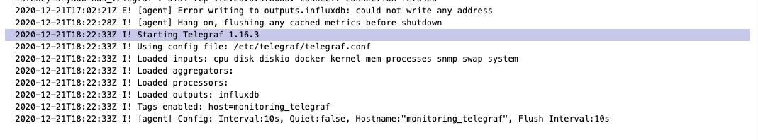

J'ai cru que j'avais un soucis... que telegraf ne fonctionnait plus correctement car j'avais rien dans le panel importé...
J'ai vu des erreurs dans le log de Telegraf :
2020-12-21T16:59:30Z W! [inputs.snmp] Collection took longer than expected; not complete after interval of 30s,
2020-12-21T17:00:00Z W! [inputs.snmp] Collection took longer than expected; not complete after interval of 30s,
2020-12-21T17:00:20Z E! [inputs.snmp] Error in plugin: agent 192.168.2.201: performing get on field sysName: Request timeout (after 3 retries),
2020-12-21T17:00:30Z W! [inputs.snmp] Collection took longer than expected; not complete after interval of 30s,
2020-12-21T17:00:44Z E! [outputs.influxdb] When writing to [http://monitoring_influxdb:8086]: Post "http://monitoring_influxdb:8086/write?consistency=any&db=nas_telegraf": dial tcp 172.20.0.5:8086: connect: connection refused,
2020-12-21T17:00:44Z E! [agent] Error writing to outputs.influxdb: could not write any address,
2020-12-21T17:02:11Z I! Starting Telegraf 1.16.3,
2020-12-21T17:02:11Z I! Using config file: /etc/telegraf/telegraf.conf,
2020-12-21T17:02:11Z I! Loaded inputs: cpu disk diskio docker kernel mem processes snmp swap system,
2020-12-21T17:02:11Z I! Loaded aggregators: ,
2020-12-21T17:02:11Z I! Loaded processors: ,
2020-12-21T17:02:11Z I! Loaded outputs: influxdb,
2020-12-21T17:02:11Z I! Tags enabled: host=monitoring_telegraf,
2020-12-21T17:02:11Z I! [agent] Config: Interval:10s, Quiet:false, Hostname:"monitoring_telegraf", Flush Interval:10s,
2020-12-21T17:02:21Z E! [outputs.influxdb] When writing to [http://monitoring_influxdb:8086]: Post "http://monitoring_influxdb:8086/write?consistency=any&db=nas_telegraf": dial tcp 172.20.0.5:8086: connect: connection refused,
2020-12-21T17:02:21Z E! [agent] Error writing to outputs.influxdb: could not write any address,
Jusqu'à ce que j'édite le fichier de conf de telegraf et que je vire l'adresse ip du nas qui n'est plus allumé (mon vieux ds214play).
Et après redémarrage du conteneur, j'ai encore les erreurs des deux dernières lignes du log ci-dessus.
Mais en fait Grafana a bien les données 😄
Merci ^^

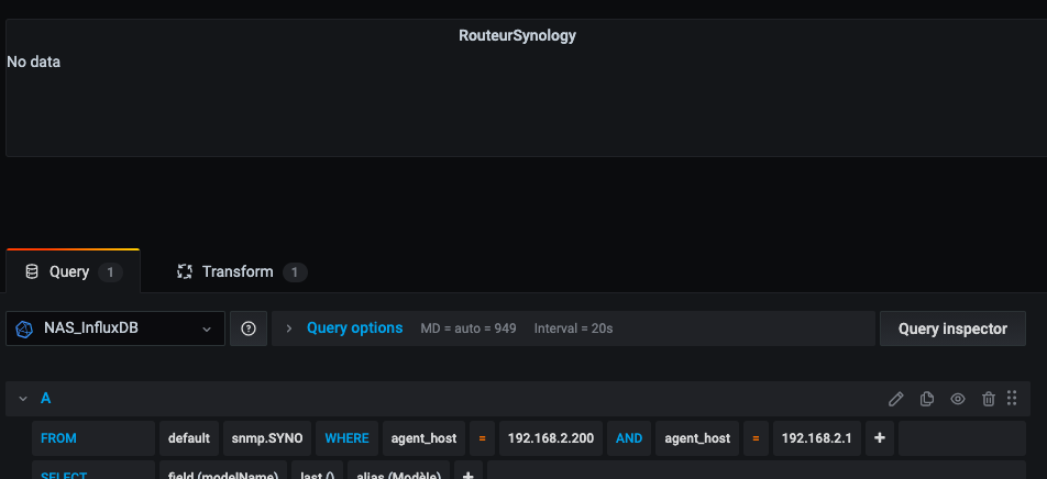

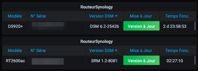

Est-ce qu'il y a moyen de combiner ces deux panels ?
J'ai essayé ça sans succès :
@MilesTEG1 @oracle7,
dsl j'ai suivi de (très) loin, mais ces 2 dernières lignes en erreur, elles continuent ? ou c'est fini ? parce que si telegraf n'arrive pas à se connecter, à un moment donné il va manquer des données !
Là c'est "nas_telegraf" qui n'arrive pas à écrire vers influxdb ....
@MilesTEG1
Sans garantie, car je n'ai pas testé moi-même avec les NAS et le routeur, mais je le fais pour mes caméras :
SELECT last("macAddr") AS "@MAC", last("manufacturer") AS "Marque", last("deviceModel") AS "Modèle", last("softwVersion") AS "Version Firmware", last("vidEncode") AS "Codec Vidéo", last("deviceID") AS "NoCAM" FROM "snmp.HIK" WHERE $timeFilter GROUP BY "agent_host"
Ce qui importe dans la reqête c'est les clauses WHERE et GROUP BY.
Pour faire apparaitre le champ "agent_host" il faut aller dans l'onglet "transform" et sélectionner "organize fields". Là tu rend visible le champ "agent_host". Ainsi il t'affichera les @IP du routeur et des NAS (enfin tous les agents définis dans le telegraf.conf.

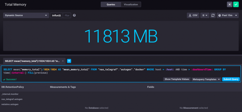

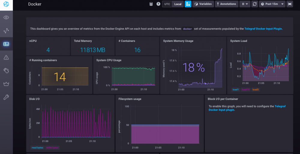

@oracle7 ça fait bien plus que ça, ça fait comme grafana 🙂

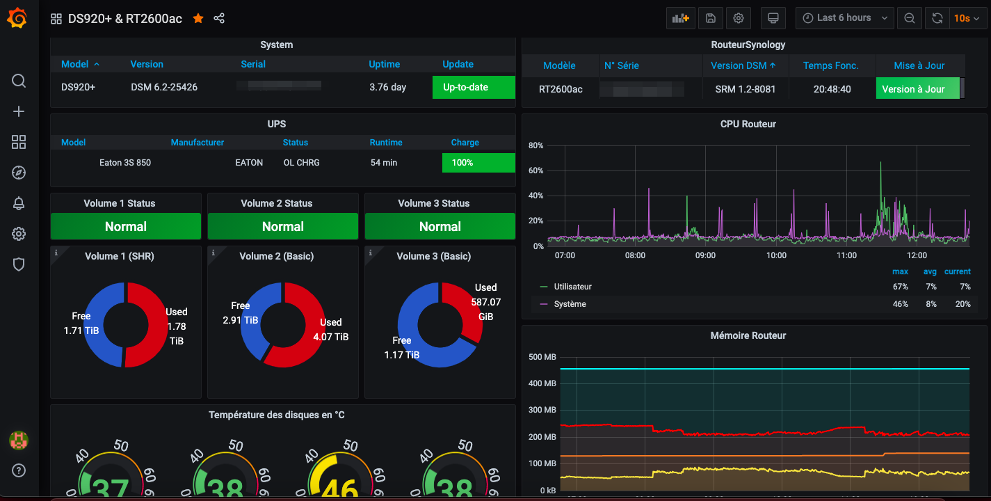

Look :
Ça me semble un peu plus complexe à prendre en main, mais ça me semble aussi plus joli ^^

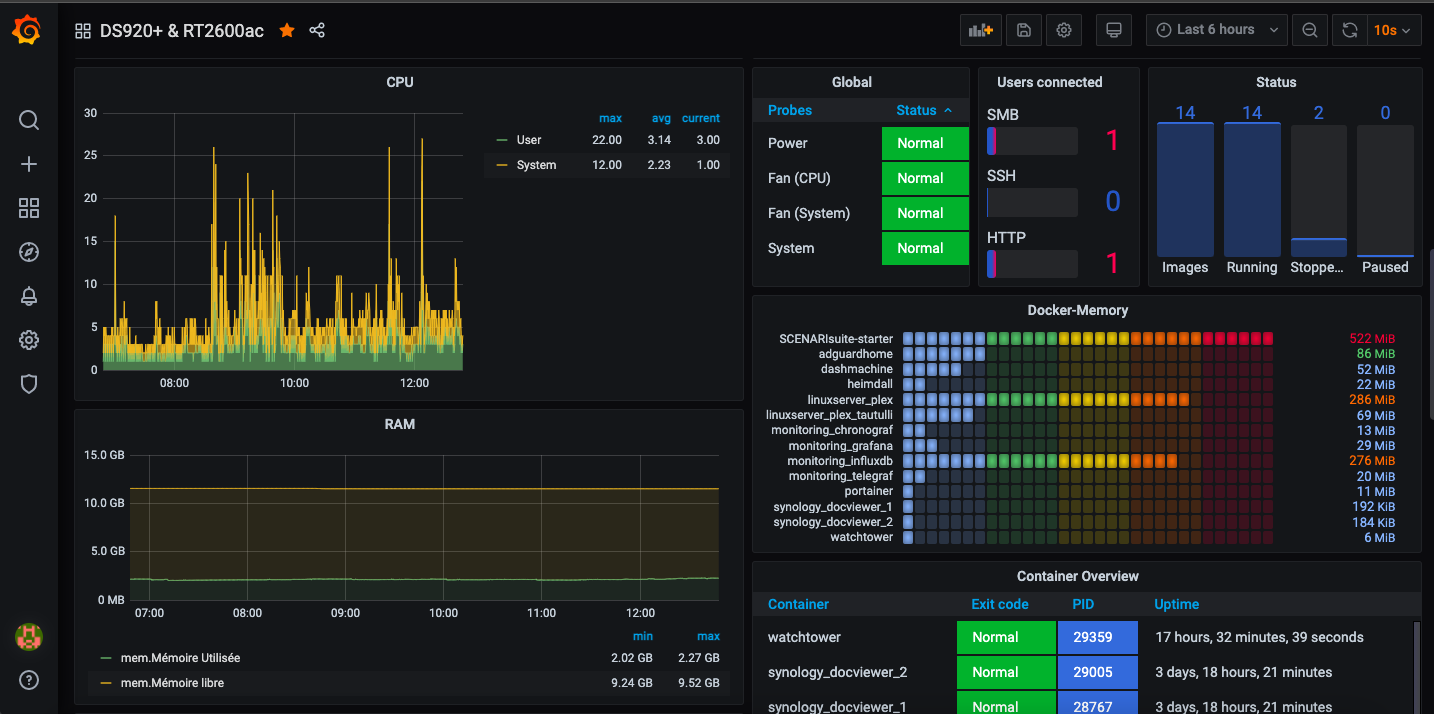

@MilesTEG1
Joli tableau de bord ! 🤗
Finalement je vois que tu n'a pas regroupé l'affichage et que tu as gardé un panel pour le NAS et un pour le routeur. A mon sens, c'est mieux de ne pas mélanger "choux et carottes" ...🤪 C'est plus lisible.
Il ne te manque plus que le monitoring de tes caméras...
il y a 2 minutes, oracle7 a dit :
@oracle7 Ha mince, j'avais complètement zapé ton post plus haut, je vais tenter ça 😉
Plus lisible hmmm, le reste c'est le bordel dans mon dashboard 🤪

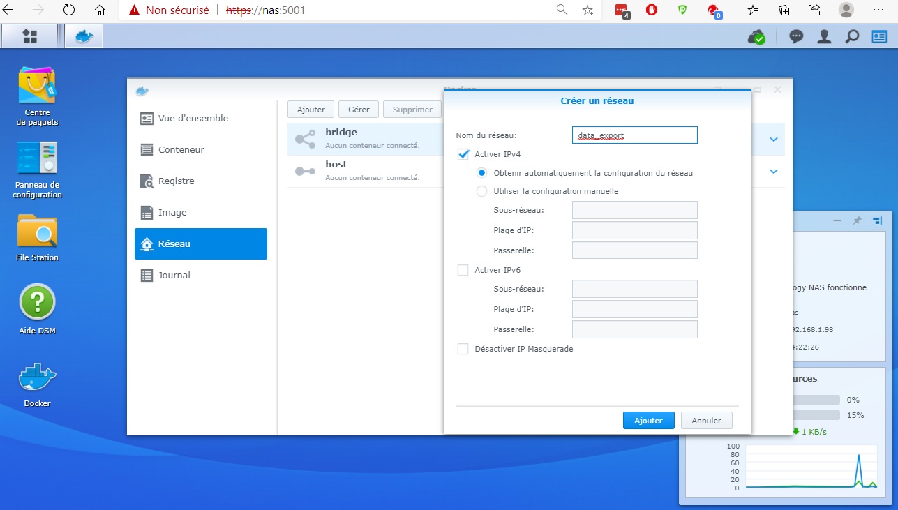

bonjour,
lu avec attention ce sujet mais je bloque au début :
création du réseau bridge. j'obtiens le message suivant:
Error
2020/12/24 14:39:59
xxxadmin
Create network data_export:bridge failed: {"message":"could not find an available, nonoverlapping IPv4 address pool among the defaults to assign to the network"}.
je précise que j'ai installé un VPN via openvpn et que j'accède à mon NAS depuis l'extérieur sans pb.
J'ai ajouté la règle : tous   tous    172.16.0.0 / 255.240.0.0   autoriser  dans le pare-feu.
une piste ?
d'avance merci

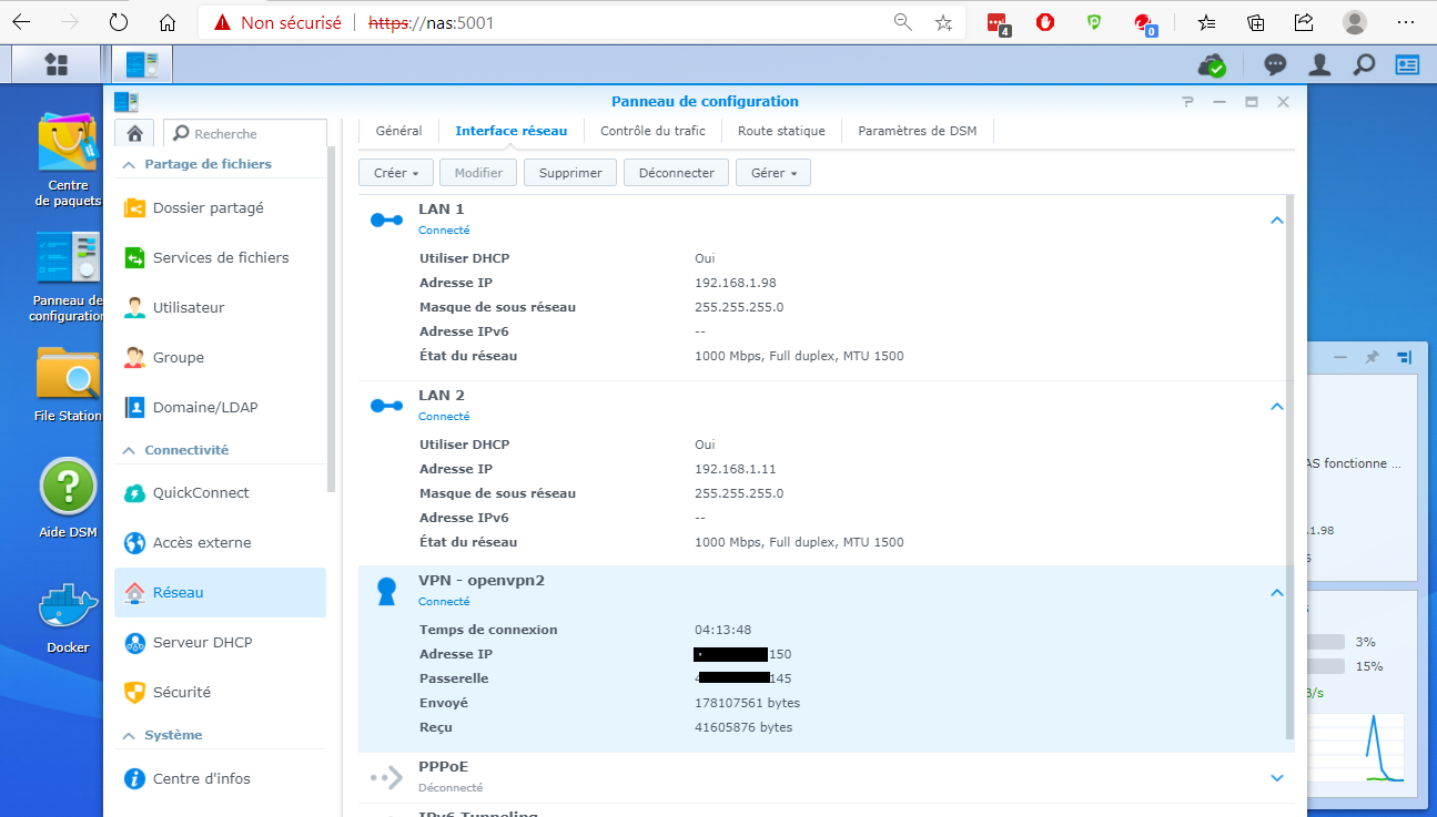

Bonjour @Philippe D,
ce n'est pas un problème de pare-feu. Peux-tu donner la liste et les caractéristiques  des réseaux configurés, ainsi que les caractéristiques de celui que tu es en train de créer ?
Bruno78
bonjour @bruno78,
voici ma liste réseaux :
lan 1 & lan 2 sur un switch et livebox
openVPN2 : mon VPN "PureVPN "
je ne rencontre aucun pb en LAN ni en WAN.

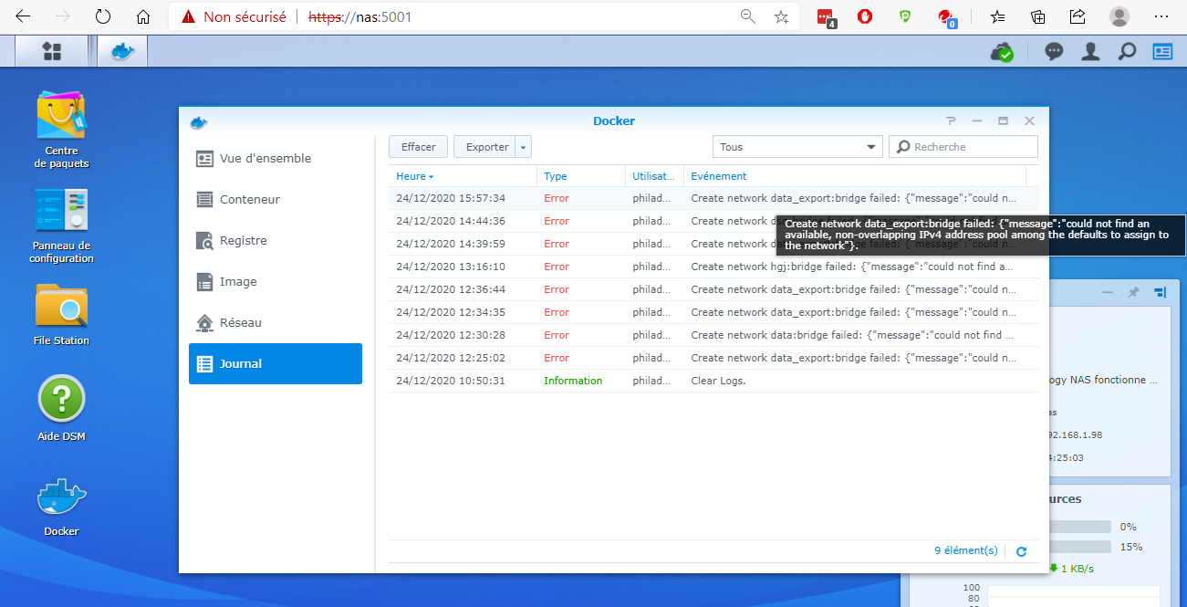

Celui que je veux créé est la  :
et j'obien ce message d'erreur dans les log : 1880645068_dockerrzo2.thumb.jpg.7fa6e3f0ce420d1c9b0e23d3b555086a.jpg
je bloque  😞
Merci pour votre aide
Modifié par Philippe D
photo en trop

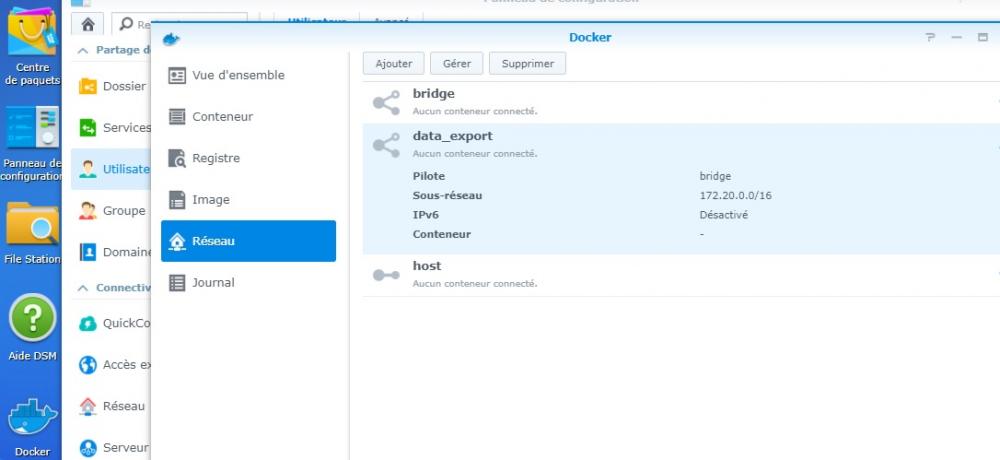

@Philippe D
Tu peux poster le résultat de ces commandes en SSH sur ton NAS (connecté avec root, sinon rajouter sudo devant chaque commande) s'il-te-plaît ?
docker network ls
docker network create data_export
Si cette dernière produit la même erreur, essayer :
docker network create data_export --subnet="172.20.0.0/16"
Modifié par .Shad.

philadmin@nas:~$ sudo docker network create data_export --subnet="172.20.0.0/16"
1d234e3a4f9a43ec9f89827c1ec9661a982da8aa02807622aded941f3d362d66
philadmin@nas:~$
